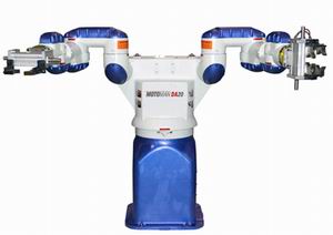

双腕机器人DA20
企业:首钢莫托曼机器人有限公司 日期:2010-01-28
领域:未设置 点击数:1801
型号Model
MOTOMAN-DA20
最大动作范围
Maximum Range of
Motion
Central Turning Axis ±180°
S-Axis (Turning) R1: +80°/-190°
R2: +190°/-80°
L-Axis (Lower Arm) +230°/-30°
U-Axis (Upper Arm) +215°/-35°
R-Axis (Upper Arm Twist) ±180°
B-Axis (Wrist Pitch/Yaw) ±120°
T-Axis (Wrist Twist) ±180°
最大速度
Maximum
Speed
Turning-Axis 170°/s
S-Axis 170°/s
L-Axis 170°/s
U-Axis 170°/s
R-Axis 300°/s
B-Axis 300°/s
T-Axis 580°/s
允许力矩
Allowable Moment
R-axis 58.8 N · m
B-Axis 58.8· m
T-Axis 29.4· m
允许惯性力矩(GD2/4)Allowable Moment of Inertia R-axis 4 kg·㎡
B-Axis 4kg·㎡
T-Axis 2 kg·㎡
本 体 重 量Approximate Mass 240 kg (529.2 lbs)
定位精度Repeatability ±0.1 mm
载 荷 重 量Payload 20 kg (44.1 lbs)/arm
