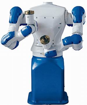

双腕机器人DIA10DIA10
企业:首钢莫托曼机器人有限公司 日期:2010-01-28
领域:未设置 点击数:2017
型号Model
MOTOMAN-DIA10
最大动作范围
Maximum Range of
Motion
Rotation-Axis (Waist) ±180°
S-Axis (Lifting) ±180°
L-Axis (Lower Arm) ±120°
7th-Axis (Lower Arm Twist) ±180°
U-Axis (Upper Arm) ±130°
R-Axis (Upper Arm Twist) ±180°
B-Axis (Wrist Pitch/Yaw) ±100°
T-Axis (Wrist Twist) ±180°
最大速度
Maximum
Speed
Turning-Axis 170°/s
S-Axis 170°/s
L-Axis 170°/s
7th-Axis 170°/s
U-Axis 170°/s
R-Axis 250°/s
B-Axis 250°/s
T-Axis 500°/s
允许力矩
Allowable Moment
R-axis 31.4 N · m
B-Axis 31.4· m
T-Axis 19.6· m
允许惯性力矩(GD2/4)Allowable Moment of Inertia R-axis 1 kg·㎡
B-Axis 1kg·㎡
T-Axis 0.4 kg·㎡
本 体 重 量Approximate Mass 220 kg (485.1 lbs)
定位精度Repeatability ±0.1 mm
载 荷 重 量Payload 10 kg (22.1 lbs)/arm
